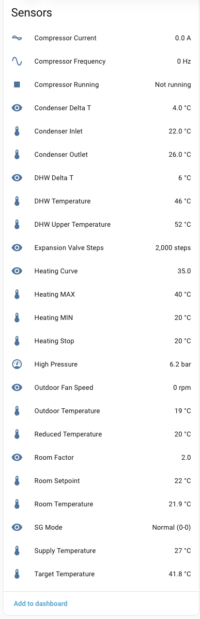

I eventually got everything in Home assistant :
But I think I accidentally did something wrong with the grnd/12v and have issues with the bus (not the display) so I'm resolving that at the moment.
I still get the signal, but when I connect the RS485 I get errors
